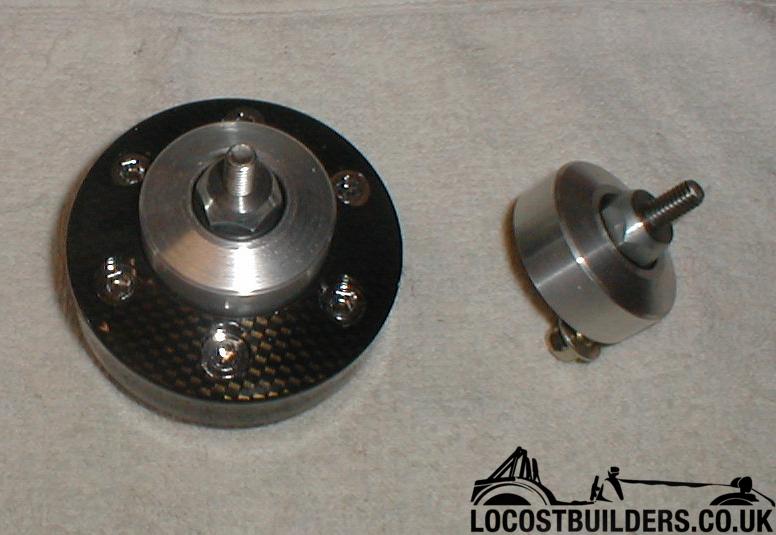

Hi David,
A couple of pictures of my wheel centers you will probably get the idea from the pics,
Basically an aluminum wheel center with two small bearings in with a bolt through the middle.
I've had them on the car for about 4 years now with no problems! I think I've probably only repacked the bearing once!
Cheers Dave..............
posted on 13/7/07 at 02:23 PM Reply With Quote
Very neat, Dave! I might investigate that option...

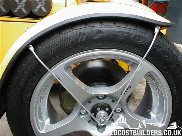

Well, first thing an engineer would probably tell you to do is toss the fibreglass and go with carbon fibre wings . Reduce the forces on the brackets is step one IMO.
I would guess there are 2 ways to deal with this, either use tapered spring steel and let it flex, or make it stiff enough to not flex enough to fracture.
What is the average weight of a fibreglass wing? I will see if I can convince an engineering student to do a cycle wing in FEA for his class.
Ive wondered if a cable would work. Pictured in red and pulled taut it would be loaded in tension and take the shock load of the downward movement of the wing. Cables generally dont like shock loads, but Im sure it could handle that much. Or at least give you warning when it snapped.
