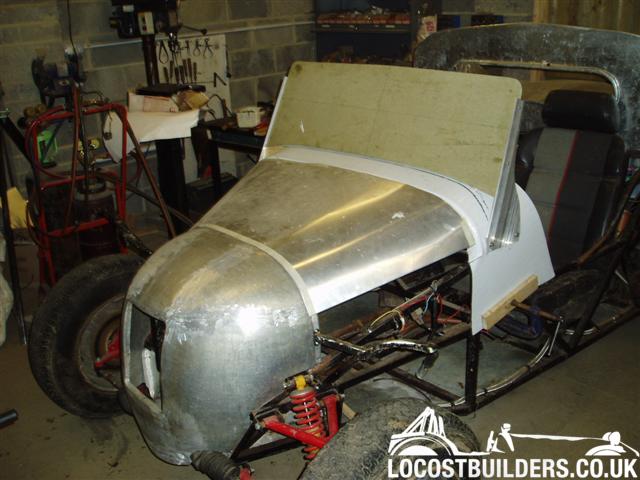

For pillars on the trials car, I am using 150mm wide by 6mm thick aluminium extrusion. This was a stock item at my local non ferrous suppliers and is very stiff. It can be cut easily with a jigsaw. I used a coarse woodcutting blade with plenty of WD40 for lubrication. With aluminium it is important to use a coarse blade to prevent it from clogging and jamming in the job.
The frame material that I am using has 3mm wall thickness which is needed to take M6 holes to fix the screen to the uprights.
John
