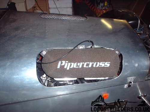

After fitting the new engine the hole in my bonnet didnt line up with the new carbs,so I have had to cut it bigger,prob is it looks pants now,any
ideas how I can tidy it up a bit.

I would make up a sort of shroud type cover. Maybe from alu like you have, or even moulding a bit of carbon (but would involve more work). Something
that fits over the large hole to cover up the original edge, but better fitting to the actual shape. Clear as mud right?!

I had a similar problem on mine when I fitted my new plenum. I was unsure how to make a subtle cover so I made a feature of it instead! I quite like
it now as it hints to the engine inside.

That looks pretty cool,I like it.Not sure I could get away with that cos the filter sticks out a long way.

what I would do without resorting to scoops is to make an escutcheon.
I think that is what they are called - bacially a surround for the hole in the bonnet riveted on.
The sheet will have the hol cut out to correct size/shape and then you would have an equal amount of metal aroudn the hole so that it covers up the
messy hole.
Take a peek at my photos as I have something similar on mine - an uneven hole covered by such a piece - may make more sens whenb you see the photo.
