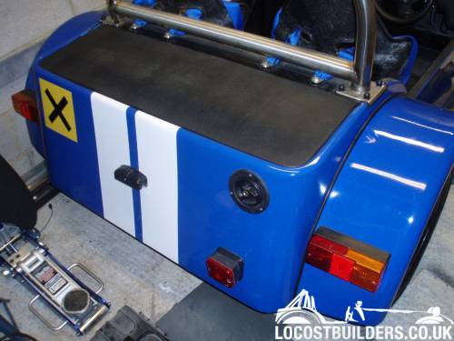

The Baron
| posted on 12/5/08 at 07:15 PM |
12mm MDF, radiused edge with a router, covered with black vinal. screwed in place from below.
Took all of about 1/2 hour to make and made from stuff that was laying around the garage.
[img]http:// [/img]
