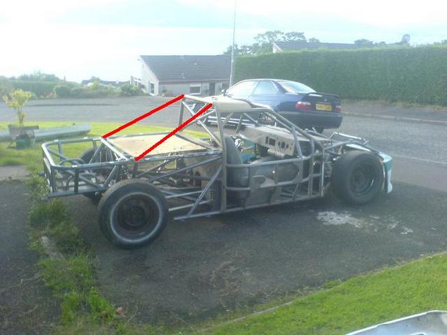

maartenromijn
| posted on 30/10/08 at 01:49 PM |
I'd rather crash in the yellow one. Matter of style....
Your project looks good btw. Have you designed the chassi yourself? Does it have 7-style geometry underneith?
BLOG: http://thunderroad-super7.blogspot.com/
| posted on 30/10/08 at 01:55 PM |
saying that dude...

| posted on 30/10/08 at 02:00 PM |
quote: Originally posted by Mr Whippy
saying that dude...
yeah, i haven't bought those bar yet, but they will be there!
| posted on 30/10/08 at 02:06 PM |
saying that dude...
cool just checking , looks very impressive btw

<--- its one of them
nooo, didn't design it myself. its an ex race car. similar suspension etc to a 7 though, but uses a watts linkage at the back.
