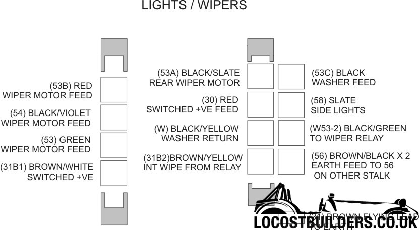

I have all my steering column connections sorted apart from one that I want to check.
If you look here
you can see that there are 2 identical brown/black wires coming out of terminal 56
I am using the MNR loom so this connection should go to the 'headlights out' terminal but I want to check to see if I should split the 2 wires at terminal 56 or simply splice them together before connectin to the MNR loom
hope the above makes sense - if not the connection I am refering to is in section 16 in the MNR loom manual
thanks in advance
stuart_g
posted on 29/5/08 at 10:42 PM Reply With Quote
I cut the link wire and connected each of the brown/black wires to the individual wires in the MNR loom, all work perfect.
There is a mistake in the instruction sheet with regards to the horn wiring. pin 54 and 53c are the wrong way round.
[Edited on 29/5/08 by stuart_g]
Dusty
Don't join them. One goes to the 56 terminal on the other column switch. the other to switching earth on the headlight of/on relay.
markyb
posted on 30/5/08 at 12:01 AM Reply With Quote
much appreciated - thanks
will change my horn wiring round as well
