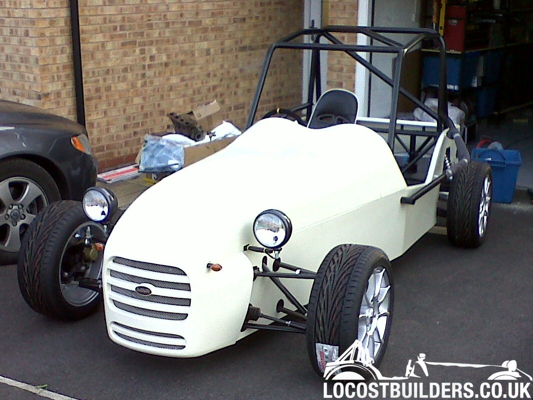

Hi guys,
Thought it was about time I said hello!
I started building my Vortx Mazda in June, having paid my deposit in March. Opted for all the doner bits to be supplied by MNR from the car they had stripped. More expensive than doing it myself I know, but more of a space issue and keeping my neighbours happy! I've managed to get to rolling chassis stage with brakes almost complete. Struggling with a leak somewhere as everytime I get it with some pedal pressure, I'll leave it for 20 mins and the feel has gone. Gives me something to do on these freezing nights!
Engine ready to drop in now. A 1.6 MX5 unit with 60k on the clock. The idea is to IVA it as is, then route up the Greddy Turbo that's sat on my workbench. Should give around 175bhp but with a better shove of torque than the bike engine I'd previously planned.
Target for IVA is the spring. Just all the engine plumbing, wiring, interior........
Lee

looking good !

car looking well hope everything is going good wait to hear and see more photos as you go iain

excellent. i started in may but am way behind you by the look of things! good work

I don't know mate, it looks like you have lots of the internal stuff done. Where as I've worked on getting its wheels on. Inside it's not quite so complete. My wife went into a panic the other day as my 3 year old little girl put the key in the ignition and turned it! How it would cause any kind of damage with me stood in the big space where the engine sits is a mystery!!!
I'll try and get some more pics up soon.
Lee
