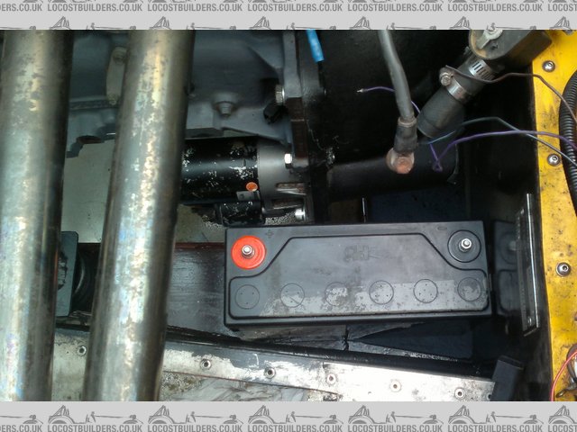

?Battery mounting position?
If I fit the battery in a box,... and fasten it, can I mount it, as per the picture?
![](/galpreviews/2012-04-05-164.jpg) ![can I put my battery here?](/gallery/2012-04-05-164.jpg) can I put my battery here?
This is so that I don't have to put it in the passenger foot well, or on the rear bulk head, the exhaust header is at least 300mm above that, so
I had in mind a GRP box, with foam inside, and then an aluminium heat shield on the top,....
Both side pods on the Fury are already full of stuff,......
any thoughts or comments most welcome
Howard

I, was, thinking, of, putting, mine, there... too.
Cant see why it wouldnt work as long as its well protected from the elements.

I put mine exactly there on my Fury.
The other advantage is that you only need a 6" lead to go from the +ve to the alternator. Low weight, but more importantly for a red-top
battery, less resistance. You don't have as many goes to get it started on the red top before it starts to run out of juice compared to a bigger
one. Saying that, if you're engine is in a good state of tune, it'll start it first time, every time. Mine always did.

Yep no problems there, I made use of some right angle alli in conjunction with the base clamp steps on the battery held down with some bolts.

check you battery specifications, some don't like it hot.
Odyssey have max temp of 50degC, although the MJ (metal jacket) versions can handle a lot more.

SO put a heat shield around the exhaust like I did with mine (ok so battery is on the other side to the exhaust on mine but..) it did wonders for the
under bonnet temperatures.

wow - many thanks for all the input, I'll have a look and see what spec the battery is, I was planning on a heat shield and insulation on the
battery too.
At the very least that means more space for the passengers feet!
