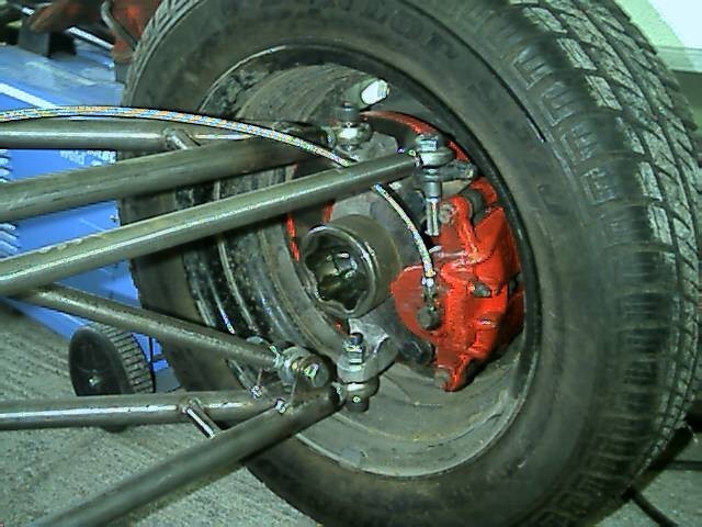

HELL ,rod ends
seen a bmw engined car for sale on e bay thats fitted with rod ends for top ball joints,?????? who the hell would design that idea.?
those things are deffinatelly not designed for that USE.
they want locking up. how bloody dangerious is that ?

Without seeing the car in question it's impossible to say if it's dangerous or not. There are plenty of Locosts using rod ends instead of
Transit drag links on the upper wishbones.

| posted on 11/8/12 at 04:44 PM |
looks perfectly ok to me, and in the correct orientation too. could do with some of the rubber boots you get for them to keep grit out and grease in,
but perfectly acceptable.
perhaps more suited to track cars, but on a road car, with limited mileage and regularly inspected, not an issue at all

The joint only has lateral forces, perfectly fine.
If you used on the lower bone so it was carrying the weight of the car then it's a different answer as in danger of popping out.

I don't think you have understood the forces involved - there is no issue with them at the top.
I'd be more concerned about them being used at the bottom as there is a bending force on the threaded portion which could lead to fatigue
cracking and possible failure there.

Applies equally well to the Transit drag link.
Upper ball joint only gets fairly light loads in comparison to the lower joint.

| posted on 11/8/12 at 06:05 PM |
a rod end is essentially the same as a ball joint, just with both ends open and a hole (and an optional rubber cover) instead one closed end a stud
through the middle and a rubber cover...
never mind not convincing you its not safe, you've not convinced us its dangerous yet. why do you think its dangerous? isn't someone in
their garage welding a few bits of metal together, usually without any proper training, and driving it about dangerous?
its ok for IVA, its good by racing car designers, race cars corner much faster than road cars, putting higher forces through the suspension, and
they're ok with it.
fair enough you perhaps don't understand WHY and how they're perfectly ok to use, but don't go dismissing them, try to understand
why they're ok, because believe me, they're perfect for the job.
on a road car they might be subject to wear, but the owner just needs to keep a regular check on them, and even better get some of the rubber covers
on them. not a hard job.
