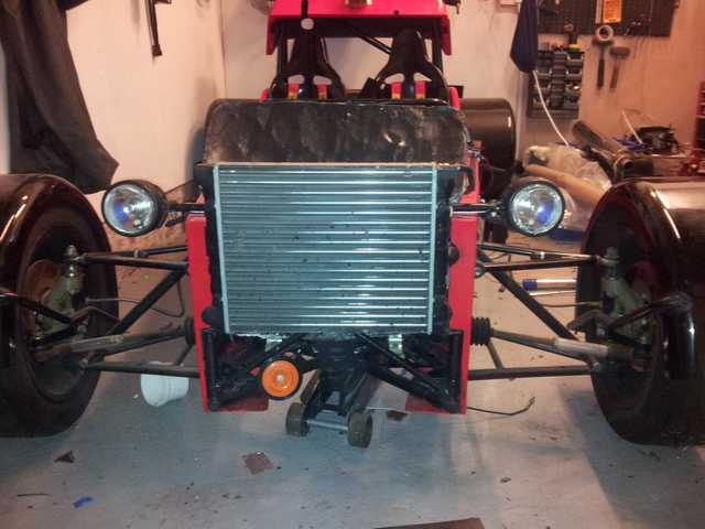

| posted on 3/1/13 at 03:44 PM |
progress pics added
RickRick
| posted on 7/10/13 at 12:24 PM |
Bit late i know but...
I'ev had this setup done (ish) now all summer, and it's been great, cools quickly in traffic when the fans come on, and stays around 90
when driving, also keeps the under bonnet temp down a lot. i did think i'd be having to make the hole i'd cut bigger (that's why
i've not put mesh in yet) but it's ok. just need to add a bit of mesh and a small lip at the front to make a low pressure area to help
the hot air out.

Is that a large plate a few inches behind the radiator 'ducting' up to the vent?
[Edited on 7-10-13 by loggyboy]

Yer it's carbon fiber layed onto cardboard because of the shape it's curved front to back but then it's sort of leant back above the
shockers so it almost meets the edges of the rad lower down then meets up with the return on the molding for the nose cone makes it a bit of a fiddle
to get the nose on and off. i've not ducted from the nose to the rad, it's vaguely closed off by carefull cutting of the nose when i
first built it
  1

Not convinced its any better than leaving it open to be honest.
Air comes through a 300x400 nose through a rad with a free air area of about 50% of the nose, then is expected to turn through near 90degrees to go
through a vent which must have a free air area of about 20% of the radiator, and thats before its meshed. I would open up some holes in that CF
backing to let some air escape in other directions.
All you have there is a giant air dam.
Mistral Motorsport
RickRick
| posted on 7/10/13 at 02:33 PM |
I know what your saying, it would be great if there was more space behind the rad to let the air come out at a more gentle angle, i did look at
trying to do the duct behind the shocks, but then would they like being blasted by hot air, and it got too close to the engine.
It's certainly no worse than standard for water cooling, and helps keep engine bay temps down about 20c and i guess whatever air is going
through the rad is coming out the top of the car, rather than going out the bottom, so less lift at the front.
like i say i was expecting to need to open up the hole in the top more than i've done but it seems ok, and adding a lip at the front will help
too
