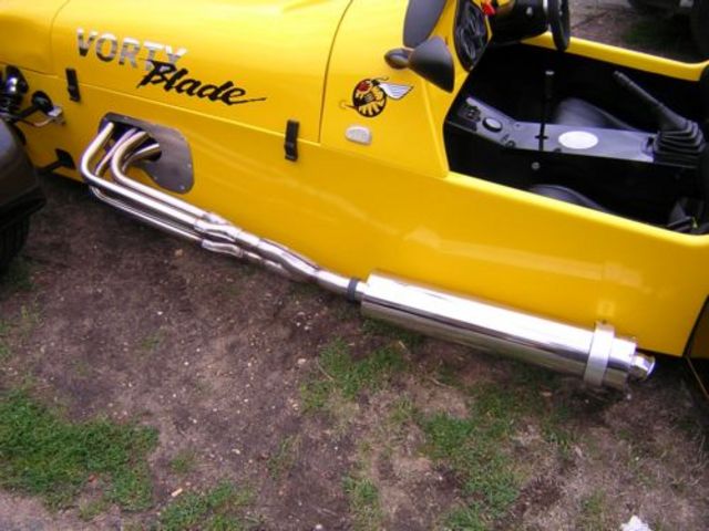

mnr equal length system
well ive got it,fitted it this morning and tested at 5000rpm and it reads 89db
roll on the track

Looks lovely and superb quality and 89db!!
How much??

Looks lovely Andy!
Ditto Shortie. How much?
Have you noticed any difference in power delivery / had it rolling roaded with and without?

as for price,il let marc do that
my car with the old exhaust was 130bhp on the rolling road,i had it set up for this exhaust at midday,it now has 137bhp and a smoother power
curve
on the road it is noticeable aswell,7bhp dont sound alot but it does make a diference

repackable can inc link pipe as per picture is £90 inc vat and carrige
manifold 4-2-1 is £390 inc vat
budget full system non repackable silencer 4 - 1 £280 inc vat

had it tested at barkston heath sprint track on saturday they tested it at 8500rpm read 92db at the prescribed distance
