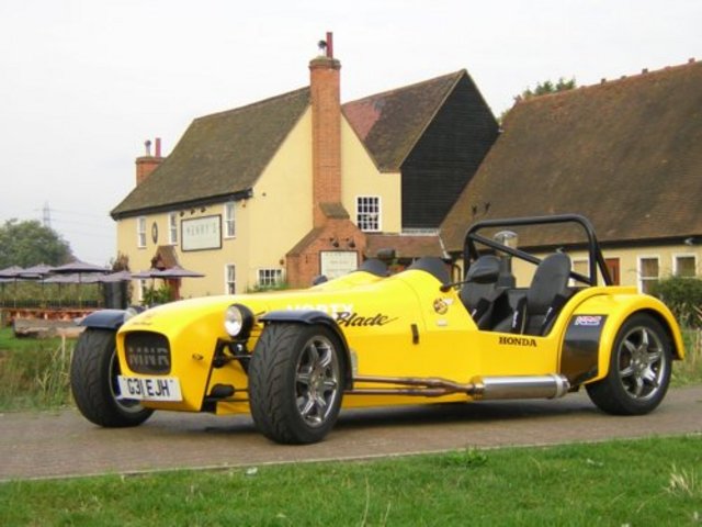

mines blade(because its well proven,strong and not that much slower than a r1,but prices for r1,zx12,busas are alot more than a blade(another
reason)
whatever one you go for youl be amazed at the performance
