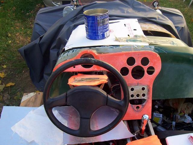

I made a fleece/fiberglass piece for the guages and then molded it to the scuttle. I don't have to worry about sva, but here is what it looks
like.

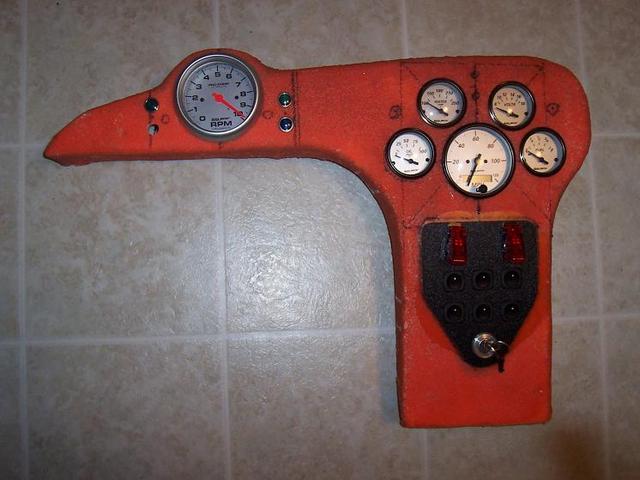

Here's another, 10mm MDF sealed & covered in vinyl. ETB guages & warning lights

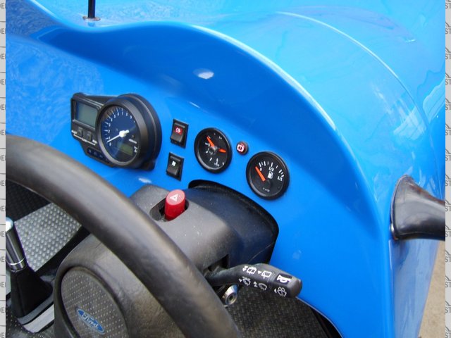

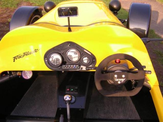

i have bike clocks in a carbon look surround
smart51
| posted on 23/11/05 at 08:25 AM |
Keep the R1 clock in the centre within the exempt area around the wheel and you'll be OK.

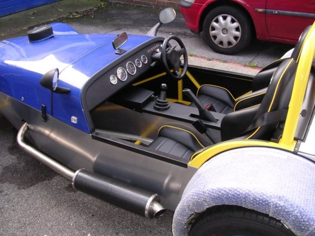

Another MDF/Vinyl/Leather creation. CAI midsize guages and lights recessed into the dash so no SVA hassles!

Smart51, I guess yours just fit inside the zone then? Im assuming, the nice big wheel plus the zone must just cover the far left of the clocks, handy
eh.
Richie

Some great designs, but I've got to say, Zetec, you've got me sold and i'm planning already.

smart51
| posted on 23/11/05 at 10:43 AM |
15" sierra wheel plus 127mm (I think) around it leaves plenty of room for the clock. The SVA guy got out a tape measure and held it up against
the steering wheel then said "I've got those same clocks on my R6"
Zetec. That dash is a work of art. I want one now.

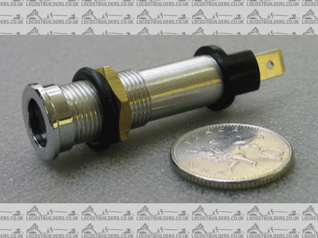

Here's a picture of the ETB warning lights, different 'hidden till lit' legends.
I'll take a close up pic of the dash later.
[Edited on 23/11/05 by wicket]

Wicket - Really like the look of those ETB ones, could be just what Im after (price asside )
Rich

smart51
| posted on 23/11/05 at 12:14 PM |
quote: Originally posted by RichieC
Smart 51 - So now much inside the 127mm were the clocks? Must have been pretty tight?
I stuck a load of masking tape to my dash and uisng a set square drew the profile of the steering wheel. I then drew out the 127mm radius and made
sure that the clocks were a couple of mm in from the maximum.

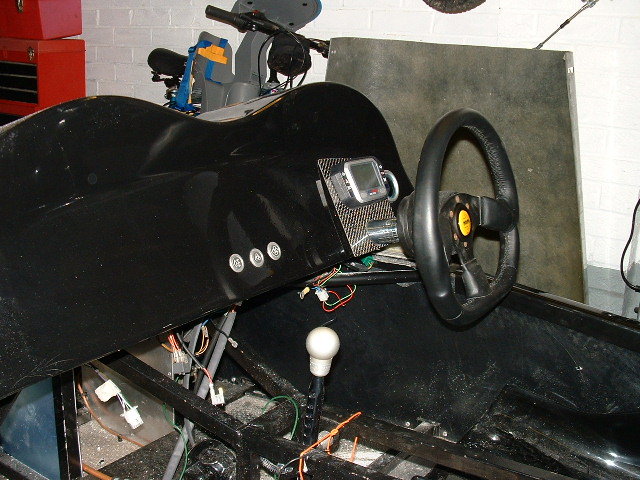

This may be of help. I too was going to mount my gauges in the centre but instead opted to lose the column cover and place everything in the line of
site. I am currently making a carbon panel to house the centre switches and also a shaped carbon panel to fit right at the top of the drivers scuttle
bulge which is housing my shift lights and a digital gear indicator. These will always be in my vision.
Howlor
| posted on 23/11/05 at 08:25 PM |
Sorry forgot to attach pic.

Main gauge is a Acewell digital unit and I have a blacked out water temp gauge next to it (Autogage). This is from another angle.
