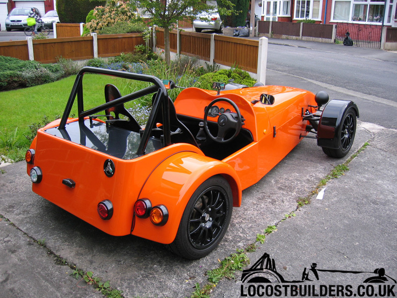

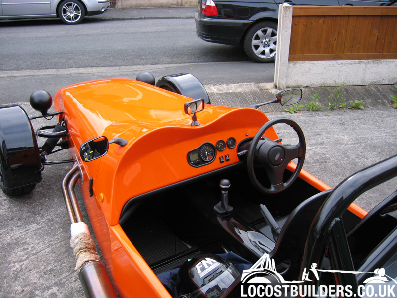

Heres a pic of the car before it left, and 2 more in my photo archive.
  Pre SVA nearside
----> Pre SVA Dash
----> Pre SVA offside Rear
no Decals and black viper stripes on yet of course.. also probably going to fit a bonnet scoop and extra aero bulges

Just a quick question from me... what did you put on the bottom of the dash to achieve the 19mm radius?
pif
| posted on 10/5/07 at 10:56 PM |
graet looking car. mac 1 may be able to help with a cat hire kit. i borrowed theres last week for my sva and the car flew through the test ( co2 0.00
/ unburnts 0.01) and i did no pre work on the emissions in fact the car wouldn't even start on teh day of the test and hadnt been starting for a
week or so and after an hour at mac1 they had it running sweet. they accompanied me to the test and set the car up on the centres emissions tester.
where abouts are you in sw manchester as it may not be all that far to mac 1 for you. if i can help with out let us know. I'm in glossop and
have a car full of sticky, rounded, soft, radiused things that may help for your retest.
pif
been a bit of a rush job really, bodged it all together in just 5 1/2 years.
Dillinger1977
| posted on 11/5/07 at 08:06 AM |
cheers pif, i'll give the chaps at Mac1 a shout
fortunately, rounded bits are sorted, they are the things I breezed it on!
coozer: all the under dash padding is done with pipe lagging covered in vinyl/leather effect material.
the diagonal ones above the knees are wrapped in the leather stuff and fixed behind with velcro.
cut your lagging to fit, take it off. wrap material around it and trim the material, leaving an inch either side so you can fold the material back
and create a 'return' rounded edge (rather than a horrible scissored edge).
get the sewing machine out (got the missus to do this bit, lol). sew the return edges and then attach a strip of velcro.
the one on the dash underside was more of a swine to fit, its a combination of double sided tape on the inside and strong duck tape on the rear
side.
the lagging is a sod to try to retain its bend. mine split along the back which helped a bit, and I also had a hairdryer on it which didnt do a lot
admittedly..
despite being easily removable, everything was done to be a permanent fixture. after all if done right it looks very nice, and is a lot safer if an
accident occurs.
I have to say though, 3/4 of the way though fitting it I wished i'd just got some doortrim and bodged it..
glad I didnt now though!
