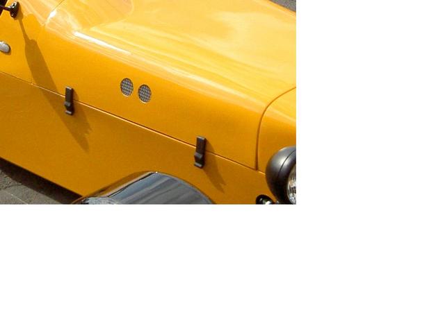

I'm having a bit of a problem with heat, and I'm trying to improve the situation.
For now I have fully tunneled the nosecone to rad, so all air in the engine bay is hot.
I'm having oil temperature issues, but I admit that engine intake is using hot air after the rad (no vent whatsoever).
I'm using a pipercross sponge filter.
What are the cons / pros of using the MNR air scoop?
a) will it lower engine bay's temperature?
b) will it raise pressure after the rad, though making it less efficient?
c) should I just add side vents in order to let the heat escape?
d) will it disturb the air leading to problems in air admission?
Thanks,
Joao

IMO you should duct the air filter intake to cold air, probably below the rad. Installing a couple of vents further back will probably improve airflow
and let the heat out more efficiently.

Having suffered similar problems I fitted a pair of Metro bonnet vents, plus a louvered vent each side of the engine bay. Worked a treat. HTH Ray

If its engine bay temp you would probably need some vents near the back of the bay to get the air out. Some nice loubres in the side of the bonnet or
something as chippy says.

I've cut a couple of vents in the bonnet.
To stop any water, I just don't go out in the rain.
