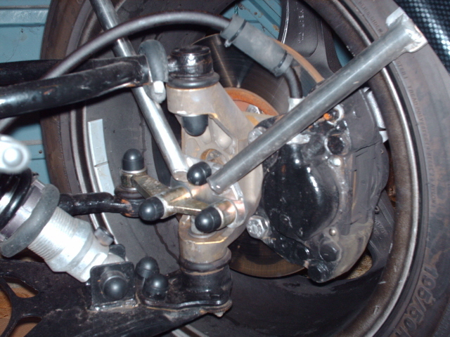

madteg
| posted on 23/2/08 at 09:28 PM |
gap
Had to put 2mm washers in mine as well works fine, attached pic
madteg
| posted on 23/2/08 at 09:30 PM |
try again
Phil.J
| posted on 23/2/08 at 10:18 PM |
Just grind a bit off the caliper to give a couple of mm clearance. Should be plenty of metal there so shouldn't affect it in any way..
britishtrident
| posted on 24/2/08 at 09:56 AM |
Grind but with care to remove the minimum metal -- caliper casting are quite thin in places.
