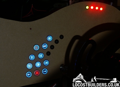

Thought I'd take a moment in the lunch break to post a few progress pictures. Tried to keep it to bits you might find interesting!
Build Showing own design dry sump tank to clear steering link.
Prog 1 DS
Prog 1 DS
Cooling and mock up dash/scuttle.
Prog 2 CS
Prog 2 CS
Mods to flappy paddle system. Removed gear cable mount (to later fit Flatshifter sensor) and welded digital dash mounting in place.
Prog 3 DM
Prog 3 DM
Digital Dash incorporating warning lights in place.
Prog 4 D
Prog 4 D
And mock up dash with switch lights and four warning lights on.
Chuffed to bits. Build is coming on a pace!

Originally posted by 02GF74
marvellous.
you certainly like your warning lamps; is there a manual to explain what they all mean!
Green LED is neutral. Three high intensity LEDs are Oil pressure warning (Manual will say HIT STOP SWITCH NOW)

Originally posted by bassett
Wow looks very nice. Are those the savage switches? if they are, are the indicator buttons warning lights or actual switches to operate the indicators.
Adam
They're Savage switches. I bought blank switches and then got the inserts when I met the guy that makes them at the Autosport International Show. Going again next year 'cause I need a rain light insert and a stop switch insert.
The warning lights are on the bottom of the digital dash except for the four 10mm LEDs in the photo'.

Bassett, I managed to find out that the part numbers for the indicator switches are;
SW3029 Indicator warning switch <->
SW3034 Individual arrow switch >
You should be able to ask any stockist to order them for you if they don't have them in stock. You'll need 2 off of SW3034 Individual arrow switch >

Clive, just a question: Are you sure that you are going to be able to reach the buttons on the dash?
We were originally thinking of putting them on the dashboard as well, but it seems that when strapped in properly, it will be just out of reach, or uncomfortable to reach, so we will place them on the centre tunnel, leaving only the warning lights on the dash.
I have to say though that we need to try everything for size once the seats are finally in, the steering is properly in place, etc. But the trial fitting says the steering wheel is pretty far from the driver, the dash being further still, the buttons could prove an uncomfortable reach...
Just a thought...
And as for the indicator buttons. We have the two plain buttons, do I understand correctly that we can order the inserts only to replace the plain ones and the part No. is SW3034?

That's why I went away from having a load of buttons on the dash and moving to rocker switches.
Also having the indicators there I found was difficult to change direction signs on roundabouts etc. It took me ages to work away around that and I eventually settled on the signaldynamics self canceling indicator system which is a dream to wire in. Makes the hazards really easy to wire up.

Yes, your right, that's why I mocked up the dash. The switches end up at finger tip distance and will be an uncomfortable strech with harnesses fully tight, as on the race track. On the road with the harnesses slightly looser they will be just about okay (being tall I have long arms). It would certainly be handy if MNR design a switch pod for the dash to bring them a few inches closer. I'll think about knocking something up in the mean time.
I've fitted a 60mm OMP steering wheel spacer to bring the steering wheel to a comfortable distance, so next job is to design a spacer for the flappy paddle system.
The product code is for the complete switch. I don't think they do the inserts separately (except at shows).
