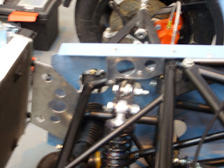

Sorry about the blurry picture, but you can just make out the aluminium angle to the right (it's the lighter looking bit) plus the bracket that
I made to support the tub at the front.

Thanks for the help so far guys. Stuart it looks quite like yours the wishbone mounts and welds are few mm above the top chassis rail and now reading
it back i get your first post as last night i had a right wtf is he on about moment
I definetly think we need a spacer at the rear as the tub is a good 1-2cm below the chassis rail as raising it up to the chassis rail makes the fit at
the top look far worse.
