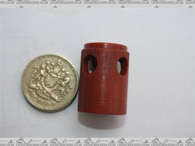

Looking at it I would say it's way past it's sell by date - I'm assuming this one is the SBD plastic one ? Is the original metal
![](/galpreviews/coinvalve Small.JPG) ![PRValve](/gallery/coinvalve Small.JPG) PRValve
![](/galpreviews/IMG_4992 Medium.JPG) ![PRValve2](/gallery/IMG_4992 Medium.JPG) PRValve2
You can see metal imbedded in the surface if you look closely so won't be using this one again.
I've run my finger around the bore on the pump and can't feel any scoring, but couldn't inspect properly due to the engine being in
the car - I may end up buying an endoscope after all.

To be honest if its stuck as bad as you say then a new pump for sure, they arent dear from Auotvaux and you can put the steel gear back in.
The SBD relief valve is very dear but its an industry standard part now in race engines so i went for one just to be safe![](/images//smilies/smile.gif)
Ben_Copeland
posted on 10/6/12 at 04:05 PM |
That is a nylon one i think... Mine was red. Is it plastic or metal? Standard one is metal.

Yes, red plastic.
It doesn't look particularly well machined - I assume the marks around it are from turning as opposed to the scores along it from where the
metal bits have inbedded.
I can't help thinking I could machine something better, a hell of a lot cheaper. Has anyone got an old standard metal one for me to get accurate

Having had a lot of problem along these lines, tried the nylon valve, it also sticks! Eventually bought a new pump, with standard valve (steel) and
never had any problems since. Replace your pump. Forget the stupid nylon valve. Don't forget to check your pick up pipe gauze isn't
holed - small particles in the oil jam the pressure relief valve.

Just spoke to SBD - again very helpful.
Apparently the red plastic valve that I took out must be a copy - he said theirs are white nylon.
They can supply OE pump for £228 + Vat
I really would like an engine attached to it for that money
Has anyone dry sumped one and if so was it difficult ? reliable ? expensive ?

Gawd the standard pumps have gone up
There are others out there to supply the oil pump, so a search on Google might be a way forward
QED are another worth contacting and it might be worth trying the local engine builders/re-con engine suppliers
*If* this is going to be a good spec' XE and you will doing some track days then Dry sumping is a very good insurance policy
It ain't cheap though and you'll be over a grand before you know it (had the SBD (Pace) Dry sump set-up on mine)

You can fit a late pump which has better internals etc. because you haven't got a backing plate.
You can also get a OE replacement one off eBay (seller:trechii) who I used for most of the bits for mine. Early one is £60 odd.
