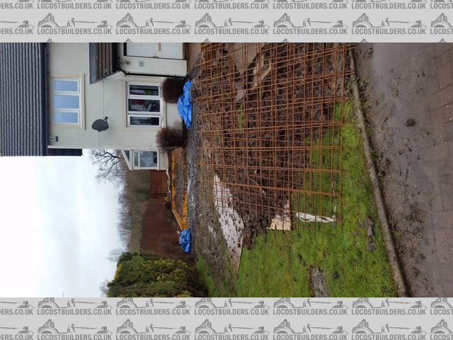

A weekend in a digger later, 30 tons of soil removed, 20 ton of hardcore spread out and I had made a right mess of the front garden but had a space
where the garage and driveway extension will be.

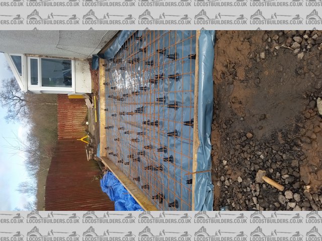

DPM down. Formwork in place. Mesh in and ready for concrete fun.
![](/galpreviews/20160222_132617.jpg) ![Gg12](/gallery/20160222_132617.jpg) Gg12

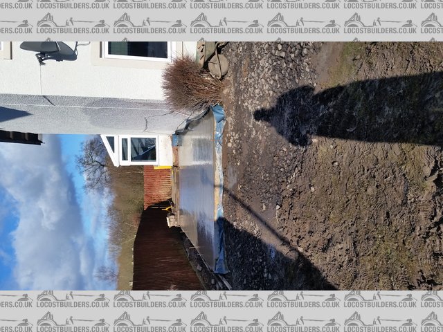

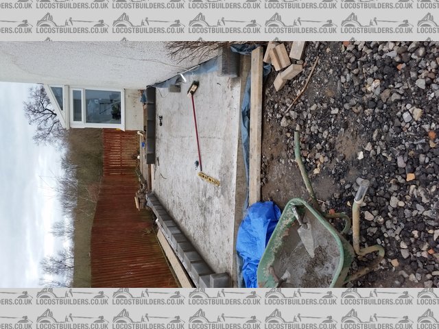

5 cubic meters of Concrete in and reasonably smoothed. Not as silky smooth as I'd like but for a first ever time doing it was pretty pleased.
![](/galpreviews/20160223_141320.jpg) ![Gg2](/gallery/20160223_141320.jpg) Gg2

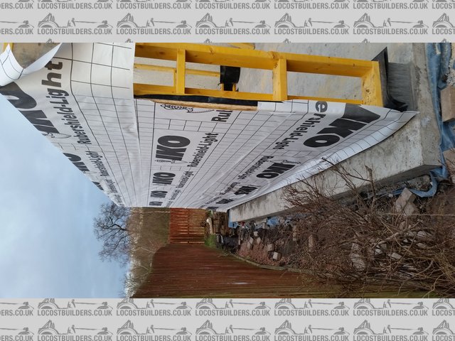

Block work dwarf wall laid.
![](/galpreviews/20160303_145841.jpg) ![Gg3](/gallery/20160303_145841.jpg) Gg3

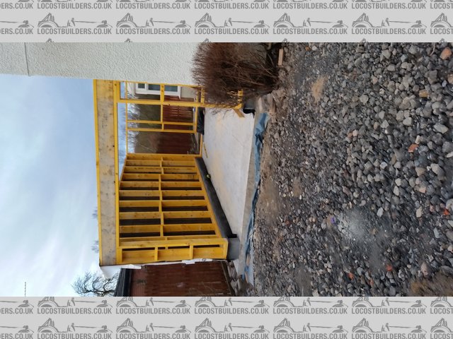

Timber frames now going up, excuse the wobbly noggins my lad was left in charge of the screwdriver!
![](/galpreviews/20160306_165834.jpg) ![Gg5](/gallery/20160306_165834.jpg) Gg5
![](/galpreviews/20160306_165846.jpg) ![Gg6](/gallery/20160306_165846.jpg) Gg6
Waiting on my trusses now which should be here this week then I can get it weather tight ish until the roller door is delivered.

Looks good but why didn't you build to edge of the base on the left. That exposed concrete will transmit damp to the inside. Although
I'm so you have a plan.
sdh2903
posted on 6/3/16 at 10:34 PM |
It's not ideal I know but was specified to have the overlap at all 3 sides. I have a very slight run on the levels so it runs away and have dug
in a perforated drain down the side to assist in drainage. Hopefully will keep the wet stuff out
