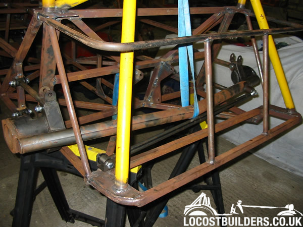

If you go de-dion then you may need to alter the rear chassis.
De-dion Mod
De-dion Mod

these pictures are yonks old now:
http://www.locostbuilders.co.uk/upload/IMG_1006.jpg
http://www.locostbuilders.co.uk/upload/IMG_1004.jpg
[Edited on 31/8/06 by ned]

if you cut off both of these chassis sections, won't the chassis mount for the panhard rod go all wobbly?
Jon
Mr G
posted on 1/9/06 at 07:59 PM Reply With Quote
Sorry, did'nt make the above picture clear. It's a modified pic of a modified pic. The 'to cut' was already there with the old position of the chassis rail. I erased the old chassis rail and put the new shape in red but did'nt erase the wording.
Depending on the pickup point for the panhard rod on the back of the dedion it will hit the chassis member with a normal poly and bolt. You can sometimes get around this by using a rosejoint instead which improves clearance.
For a proper decent clearance most dedion chassis designs have the dog leg in that rail (matching otherside too) or a similar re-design.

i didnt have to do anything and the de dion fits ok... uses sierra running gear though...

It's all down to what de-dion your using and how the panhard rod is located on it.
Book chassis with MK dedion (Which appears to be the same as the free plans available) or GTS dedion without a rosejoint and you'll get contact problems on full drop on that side.
