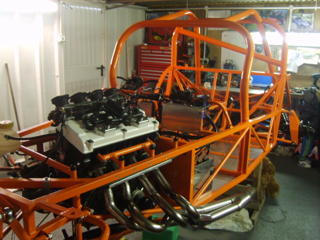

My build so far

I know a little bit orange at the moment money halting progress.Saving for the white bodywork

CosKev3
posted on 7/5/14 at 07:12 PM |
Looks great pal
Your attention to detail will make it a spot on build,the engine wiring loom looks really good now.you should take a pic of all the wiring
you've removed!
OliilO
posted on 7/5/14 at 08:05 PM |
That's rather bright!
Interesting to see that there is very little front end to the MK chassis, it looks really short with the steering rack pretty much outside the
chassis.
Gear Monkey
posted on 7/5/14 at 08:29 PM |
Very nice........And very orange ![](/images//smilies/smile.gif)

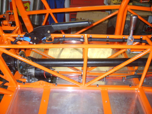

TimC
posted on 8/5/14 at 06:28 AM |
Is that a one piece prop Chap? It looks very long - has someone checked the calcs for you to say that the tube will cope?
Nice build though.
zx12r dug
posted on 8/5/14 at 07:28 AM |
Hi there the prop is not one piece there is a centre bearing there this is my fourth mk bec build and I've never had a problem with any of the
others.

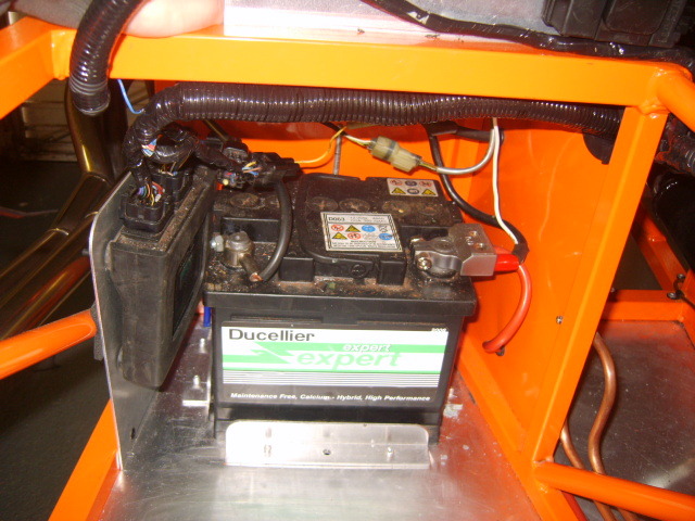

cosmick
posted on 9/5/14 at 09:55 AM |
By the looks of the size of the battery, the car is also electrically powered and no room for the passengers legs. Why such a big battery? if you
don't mind me asking.

TimC
posted on 9/5/14 at 02:28 PM |
others.
[Edited on 8/5/14 by zx12r dug]
That's all good then. Four MKs, and presumably a MEV? You've made me feel much better about this addiction.
zx12r dug
posted on 9/5/14 at 06:19 PM |
I wanted to use a car battery (off a 1.2clio) had it off a mate at work who was scrapping his car.with using a starter motor for my reverse I
didn't want to use a bike one. plus im only 5.7 il never sit on the passenger side.

cosmick
posted on 9/5/14 at 06:34 PM |
A Free battery is a good enough reason and with the electric reverse it should do 0 to 60 as quick going backwards.
