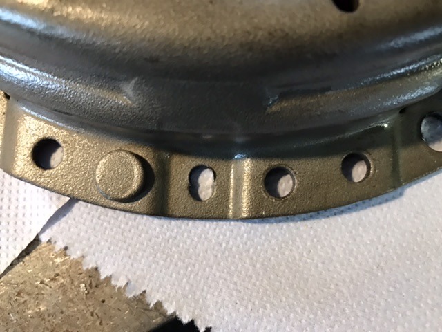

I did it the other way around on my Duratec conversion:
I.e. I drilled the clutch cover from the pinto engine reckoning that it was a less expensive thing to mess up. I also had a couple of them so I
figured it wouldn’t matter if it went wrong.
Interestingly I discovered that the clutches appear to have the same A-load datum holes (Must be punched in when they pressed the cover before it’s
machined.
So it was relatively easy to use them to align the Duratec clutch cover to the pinto cover.
I turned some stand-offs that passed through the A-load holes on both (covers face to face) and then clamped the whole lot onto a base plate with some
long M6 fasteners.
Then it was a case of aligning the holes for the location dowels and the mount holes With the milling cutter and milling through.
They are only about 1.5 mm out which is really annoying. I never measured them but I suspect it’s an imperial to hard metric conversion.
Worked like a dream- popped the cover straight on. Checked the runout with a dti. All good.
I do have a small milling machine though.
I can never get pictures to load in the posts but I will post the pictures of the modified cover in my photo archive.

![](/galpreviews/88229369-DCC0-4F3E-B7CD-6BF5AD6BD7F5.jpeg) ![Mod Pinto clutch cover](/gallery/88229369-DCC0-4F3E-B7CD-6BF5AD6BD7F5.jpeg) Mod Pinto clutch cover
