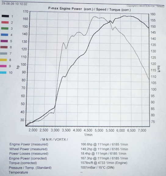

Why do you want to junk the VVT? It gives a massive boost when it comes in..
This was taken off the rollers using carbs that were NOT jetted for this application, that's why you see a huge drop off up top.
However, the power increase there at 3K makes the car very lively indeed
Bear with me....
