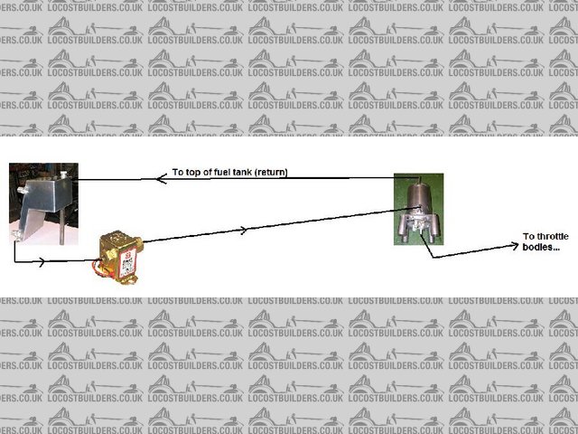

Hi All,
I'm planning to use a swirl pot containing the OE (bike) fuel pump which will be fed by a low pressure Facet pump located very close to the
bottom of the tank, as outlined in the crap diagram below (Thanks to Procomp and MK9R for photos):
Now, my question is, will the low pressure pump be strong enough to circulate fuel from the base of the tank to the engine bay, up to the outlet of
the swirl pot and back to the top of the main tank? I suspect that the return inlet on the main tank will be 400-500mm higher than the fuel pump.
Thoughts very welcome!

Should be mine pumps from the tank ( lift of 400mm ) to along the bottom of the floor upto the swirl pot in the engine bay and back same route to
tank.
Tank is top entry with suction pipe to bottom.

I've got a similar set up on mine, and its worked fine for 3 years!, as long as you have a return back to tank.

No reason it shouldn't be fine Tim, Austen copied my setup on my Fury. My swirl pot ended up sitting above the fuel tank.
Not very Locost but very BEC

Your diagram is missing a return from the fuel rail/FPR back to the swirl pot. Is this intentional?
