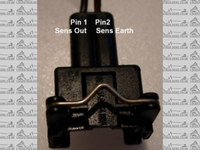

That's the sort of picture I was looking for - but now I'm really confused... you talk about "sens out" & "sens earth", but the MJ wiring diagram has "+" and "-". Is "sens out" the "+" and "sens earth" the "-"?
Everything I've read about the sensor emphasised that the connection should be right way around. As everything else will be new work(MJ, wiring, EDIS & coil) I'd prefer to get as much right as possible to reduce the confusion when trying to start the car for the first time...

Just found this , it may help.
posted on 3/12/06 at 10:13 AM Reply With Quote
Magic! Ta muchly...
Sort-of says the same as Dusty's picture, but with recognisable terminology (coo - big words for a Sunday morning!)
