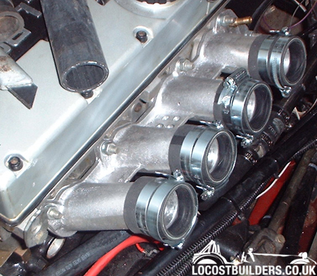

After my fiasco with the Turbo shop,I managed to get a cast manifold pretty impressed with it.There was no need to respace the carbs either and because it is cast the transition is nice and smooth.

That looks great - my turbo shop manifold was crap as well.
How much was it?

...and where from? I'll be needing one eventually, had only seen Bogg Bros ones till now.

Got it from here linky
Its not shown on the site as its new.cost was £175 that was including rubbers clips postage and vat,and no waiting.

It would be usable but needs some finishing as it has the same steps between the inlet and the plate as yours does.
Given that it wasn't angled up it would have been a right pain to fit as well.
Buying a Bogg Bros one would have made my life much easier.
As it is I've had a go at making my own using the bike rubber inlets and a piece of Ali plate. It fits OK, but remains to be seen if it will work as the inlets are very short.
Being short means that it fits nicely within the chassis though.
If it does work it will have cost £20.
