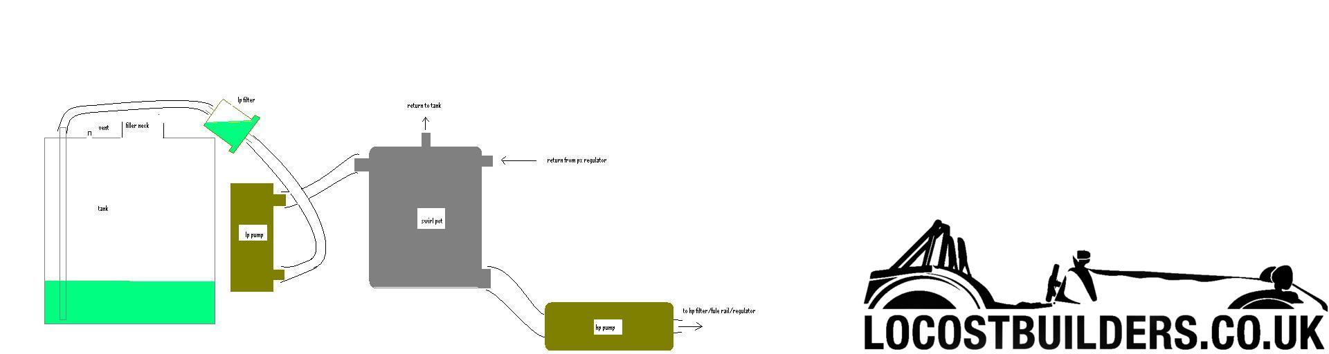

my lp pump is a facet silver top which is sucking the fuel through a generic clear filter and up a dip tube in the tank...
the filter is currently sat at an angle downwards. swirl pot is about 1.5l
thing i cant get away from is the idea that the swirl pot is emptying and starving the hp pump..... possibly due to the lp pump failing to draw fuel
effectively from the tank... although that matches the symptoms i cant see how it could be related to the fuel level being eith 1/4 or brim
full....
this is getting really frustrating but i dont want to shell out a fortune on new hp and lp pumps if i dont need them!
obscure thought but could the angle of the lp filter cause starvation? there is always an air bubble in there when running which grows when
sropped.....
added a diagram to help explain....

MikeRJ
| posted on 12/5/09 at 03:56 PM |
Not sure if you answered this, but do you have a return from the swirl pot back to the tank? This is very important, otherwise the LP pump can not
purge the swirl pot of air.
DaveFJ
| posted on 12/5/09 at 03:58 PM |
yup - on the diagram
of course i dont know for sure it isnt blocked............
Dave
MikeRJ
| posted on 14/5/09 at 11:12 AM |
Sorry, didn't see the link.
One thing that does stand out is you are asking the LP pump to lift fuel all the way to the top of the tank according to the diagram; this is likely
to cause priming issues when the tube is full of air, for instance when cornering and the fuel sloshes away from the end of the pipe.
Normally the fuel outlet would be near the bottom of the tank, and the pump would be mounted level with or lower than the bottom of the tank.
If possible I'd suggest checking the low pressure return when the problem occurs, rather than the high pressure side. If no fuel is making it
through, then chances are the swirl pot has emptied because the LP pump can't prime itself.
[Edited on 14/5/09 by MikeRJ]
