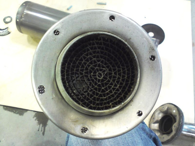

In the interests of track day noise level reductions and the way things seem to be going, I've got an R1 silencer in the garage from an 02-03 bike. It's titanium on the inlet end and the outlet is something else (it's magnetic so not titanium). I've found a local exhaust fabricator who can weld titanium for me but he asked me to open it up and send him some pictures so he can see whats what so we can figure out what to do with the link pipe.
I removed the end caps but the inner pieces seem to be soldered on to the blue outer piece.
Anybody know how to separate them.
I'll try and stick up a picture in a bit to show what I mean. If it's just solder I guess I can take a blowtorch to it to melt it then separate?

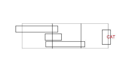

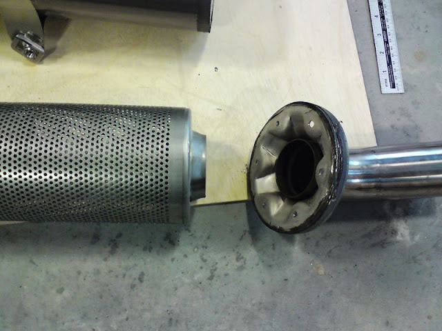

You can't weld stainless to titanium or vice versa (at least not without difficulty and risking cracking in the weld). The inlet piece is titanium and the outer housing also but everything else is slightly magnetic so probably stainless. I've now cut off the titanium inlet and will try and get a custom made inlet to replace it.
Here's some pictures of the insides and a little drawing. Hopefully I'm booked in for next week to get it welded up. I'll add to the post how I get on.
