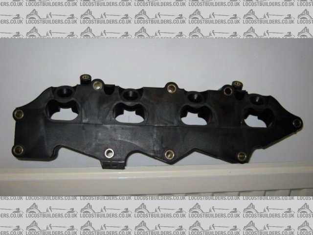

AdrianH
| posted on 22/5/11 at 08:53 PM |
quote: Originally posted by AndyW
they use the original inlet cut down to make a sandwich plate so you can use injectors.
Does that mean I can use this that I did some months ago?
Must admit I thought that it would be better with taper down it's length.
Adrian
