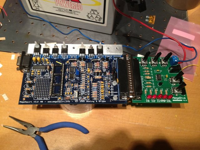

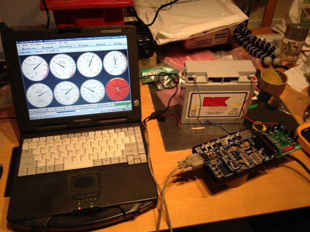

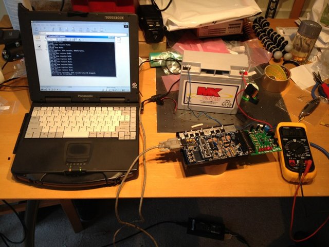

AntonUK
| posted on 11/12/11 at 05:31 PM |
Success (with Pic's) Megasquirt: Standard or Extra Code?
All done bar the ignition outputs as I am waiting on a delivery of another BIP373.
Main Connector done too...
Connects to the PC and does what its meant to with the stim plugged in.
[Edited on 11/12/11 by AntonUK]
scudderfish
| posted on 11/12/11 at 05:46 PM |
Excellent! That must be very satisfying.
AntonUK
| posted on 11/12/11 at 05:50 PM |
Very... the other half doesn't get it tho
Just need to finish the engine and really see if it works
