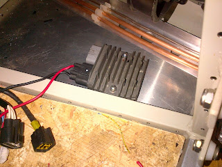

coozer
posted on 18/8/13 at 02:42 PM Reply With Quote
I'm doing just that right now, I'm using 8mm copper for the feed from the pump and 10mm copper for the return to the tank. All riveted to the frame with the correct size plastic P clip.
