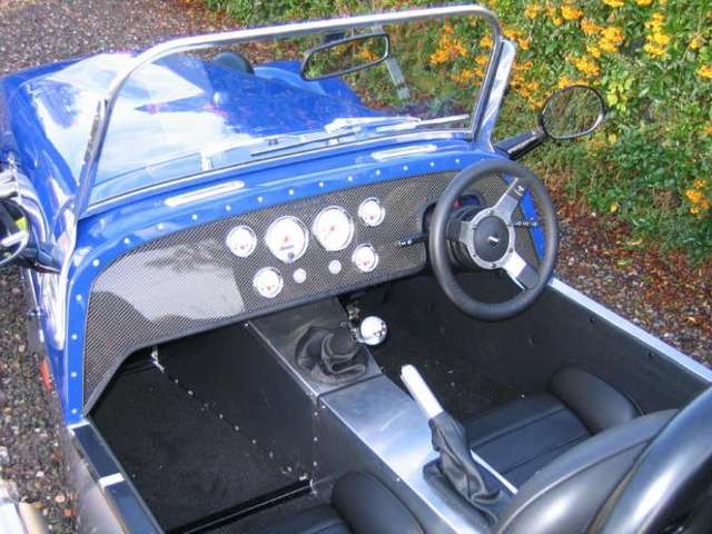

Steering wheel - its a Mountney (allegedly) SVA compliant item. Is it OK or do I put the Sierra wheel back on?

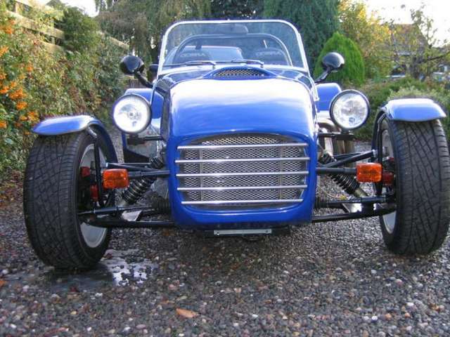

Front view
![](/galpreviews/front-800.jpg) ![Description](/gallery/front-800.jpg) Description

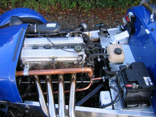

Engine bay
![](/galpreviews/engine1-800.jpg) ![Engine 1](/gallery/engine1-800.jpg) Engine 1

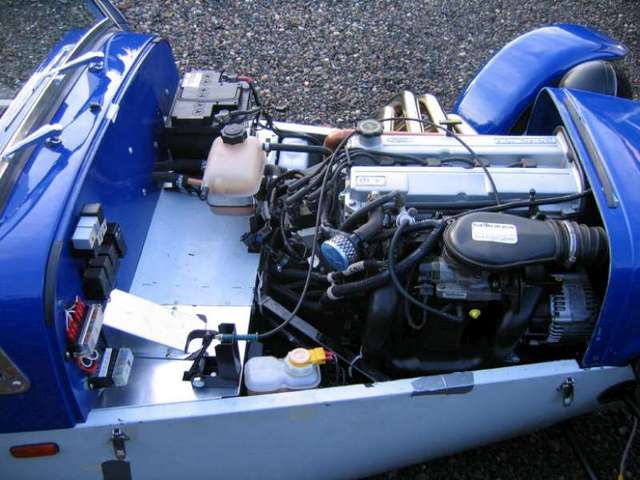

Engine bay again
![](/galpreviews/engine2-800.jpg) ![Engine 2](/gallery/engine2-800.jpg) Engine 2

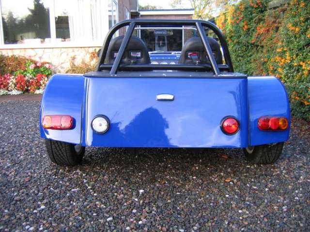

Rear end
![](/galpreviews/back-800.jpg) ![Rear view](/gallery/back-800.jpg) Rear view

Interior (last one!)
![](/galpreviews/interior-800.jpg) ![Interior 1](/gallery/interior-800.jpg) Interior 1

steering wheel, if thats the one in the pic put your sierra one back on.

if the dash is not 'rolled' at the bottom don't think it will pass.

1. The battery terminals may need covering
2. Top ball joint nut covering
3. Bonnet catches may fail radius - most people use the rubber ones for SVA, however you could probably make some covers from something.

RichardK
posted on 1/11/05 at 08:52 PM |
Nice motor mate, the only thing I noticed and am probably talking b0ll0cks but the larger dia copper pipe running across the top, the bracket that is
securing it to the rocker cover does that need to have some sort of sleeve to stop chafing like on brake lines and clips. I'm sure other
members will be more knowledgable than me. Hope mine turns out as well as that.
Rich

The dash is a flat carbon fibre panel, with a u-trim on the edge (as per the Luego build manual) but I'm not sure about it passing.

rear reflectors if built into lights need to be vertical, have you covered the exhaust fixing brackets

from memory i think the dash bottom has to be 19mm radius??, may be wrong but worth checking

Reflectors do not have to be vertical only fog light, bottom edge of the dash is fine as long as it is covered with trim so he can't feel the
edge.
Thats correct, but also the reversing light (if fitted).

I used the same mountney wheel at my first attempt and nothing was said. As for radius of dash if its nt contactable then its not looked at. So the
rubber trim over it should be fine. Thats what the sva guy told me. Watch the folded edges on your trans tunnel. Can also be regarded as sharp edges
if they come out to far. Thats about all I can see apart from that already stated. Good luck.

2/ Bottom of dash, the SVA regs are that if solid, (unpadded), then it needs to be 19mm Rad. but if padded then they will accept 5mm Rad

The pipes to to the master cylinders will need to marked I got some from Burton Power and downloaded a spec sheet from the web, search for sytec.
Did you get the screen from Luego, if so check that the bs marking is correct should be BS857 or BS857-2. Mine was made from glass not suitable for
automotive use. I had to have a new one cut as Luego could not supply one that was correct althougth they are going to pay for it.
I see you have banjos on the front calipers, your tester may ask if the seats have been machined I said that they had and he was fine.

Not sure about your grill. If any of the tube ends are proud of the face of the nose, then it will probably fail the radius test.
The grill on my Viento (identical to yours but bigger)is proud of the front face of my nose cone, so what I've done is to slot the grp which is
directly behind the horizontal bars on the grill. This has allowed the grill to move inwards and therefore render the bars flush with the front face
of the nose cone.
There is now no edges that can be contactable with the sphere the SVA chappie uses, so hopefully will get through. You cannot see the slots as they
are behind the grill.
Do you need to have the grill fitted for the SVA anyway?
It's a shame Luego don't make the inner face of the nose a little deeper.
Save all this hassle.
Anyway, great job, certainly looks the business.
Best of luck with the SVA
Dave

Emsfactory - I think I will change the steering wheel to be on the safe side. The folded edge on the trans tunnel is a good point, I have some rubber
edge trim I can fit

Dave - the bars in the grill do stick out a ver small amount. The open ends have been fitted with caps to give them some rounding. As you suggest, may
be as well to remove for the test.
