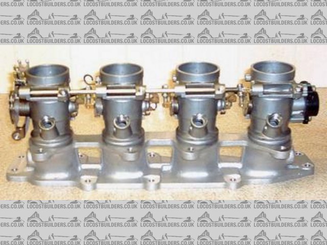

Been thinking about how best (read locostliest) to attach GSXR bodies to the zetec DCOE type manifold. New flanges and rubbers are going to cost.
Can anyone advise or see problems with simply tig welding them in place. Granted they will not be removable but I cant see myself removing them anyway. At a future date the manifold could be recovered and as good as new with a little milling if I ever found I could afford jenveys. Rescued attachment tbsweb.jpg

how about welding them to a plate, then cutting the plate to fit the manifold? then you could take them off easily with no threat of harm to the manifold.

Main problem I see with tig welding them is that if you get even the slightest bit of distortion then the spindles may go out of alignment, leading to a stiff and sticky throttle...

what about cutting the flange off the manifold, so just leaving the head flange and stubs (like an ST170 manifold) and using the bike rubbers to connect them?

Get some 42mm id tubeing and a 3mm plate
cut the tubing to 4 short lengths
weld the tubing to the plate and match it up to the manifold
Attach the TBs to this new manifold
*or*
make the manifold yourself using the same method and sell the DCOE one...

I have looked at all the above and am still stuck on cost which is why I thought about tig welding. Is it technicaly possible. The bodies are fairly solid, seat flat on the manifold, can be clamped up firmly. Is distortion a likely problem. Are the two metals likely to be so dissimilar as to make welding a no?

I made up my own adaptors using some tube and flat plate, all glued together with Technoweld. Used short pieces of coolant hose for the connectors.

It's no so much that the metals might be different, but that the process of welding involves melting metal and then letting it cool down again. As metal cools it contracts, so pulls everything towards it. When you have molten 'weld' falling on the cool(er) manifold and bodies, all sorts of interesting things happen.
Depending on the thickness of the metals and the distance between the weld point and the spindles, you may be okay.

Think I will have a go with the Lumiweld/Technoweld stuff for starters

I wouldn't even think of the welding the throttle bodies directly to the manifold, the chances of having a combined scrap manifold and throttle bodies is far too high IMO.
If they are anything like carbs, the alloy is more like a zinc die casting rather than aluminium.
If you have access to a TIG, then chop up your manifold to leave just the flange and get some suitably sized alloy stubs welded to it and connect the TB's via shrot lengths of rubber/silicon hosing as it was on the bike. Short bits of straight silicon hose is not that expensive (the bends are the expensive things). Have a look on ebay, there are often people selling Samco style hosing cheaply.
