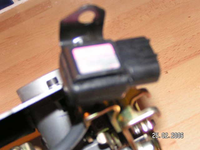

I have a set of GSXr 600 throttle bodies and I'm not too sure what the rubber pipes and sensor do. Wondered if they are still of use with
Megasquirt?

Sorry about he poor image of the sensor!
![](/galpreviews/GSXR 003.jpg) ![T/B's # 7](/gallery/GSXR 003.jpg) T/B's # 7

hey rich
looks like map sensor to me. do the pipes all connect to one pipe that goes to the back of the sensor? if they do it should be your map (manifold
absolute pressure)

posted on 25/2/06 at 08:02 PM |
The set that I have just bought have the pipes commoned and the common ends in a doohicky with a three pin socket on it. So I am also assuming that
this is the map sensor.

BKLOCO
posted on 25/2/06 at 08:24 PM |
Yep looks like MAP sensor to me.
For MS I'd just rip it off and run a pipe from the las "T" to the MS MAP sensor as we discussed earlier.

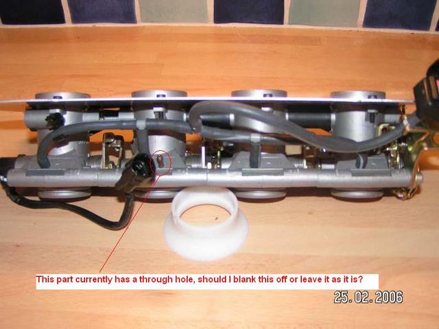

![](/galpreviews/2GSXR 003.jpg) ![T/B's # 10](/gallery/2GSXR 003.jpg) T/B's # 10
Rich![](/images//smilies/bigsmile.gif)
BKLOCO
posted on 26/2/06 at 09:06 AM |
I think I'd blank it.
Anything you connect to just one TB will pulse.
Brian

striker4age
posted on 27/2/06 at 03:48 PM |
Blank it, as it's on the engine side of the throttle plates you would never be able to balance the throttles, (I'm still not too sure how
or if you have two as they are all linked by the tube that goes to the MAP sensor.)
