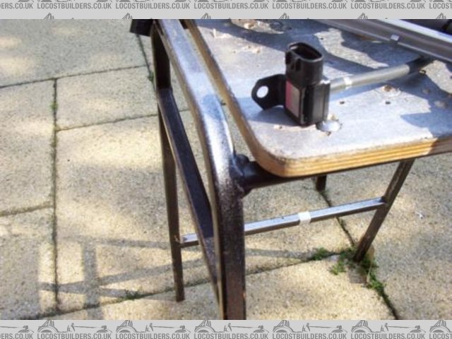

GSXR throttle bodies what this? 1
There is a black box joined to the throttle bodies via four vacuum pipes. It has a three pin plug.
What is it? Fidle valve maybe. if so does anyone know how to wire it up?

that will be your map sensor(manifold absolute pressure)

I'm using Mega squirt v3 so I guess I don't use this. is that correct?
from my post yeterday I guess I just connect this pipe to the ECU barbed connector.

Yep. Spot on.
