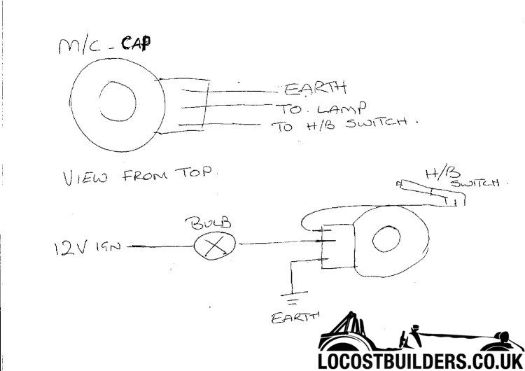

i am trying to use my handbrake switch as my warning light on dash,but can not figure out how to do it.
there are 3 wires of the brake fluid chamber ,but where do they connect to.
I was sent this by Bigrich, when I was doing mine!
Enjoy!!!
.jpg)
don't forget to Earth the other side of the handbrake switch too.
thanks mate
hand brake switch is earthed through the screws attaching it to the lever and the bolts attaching it to the chassis it does'nt have its own earth terminal
