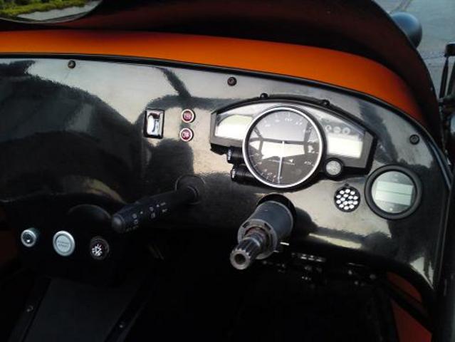

I think that's what I used, I just sent it to the chap at premier looms and he sent it back with a new sierra multiplug attached to the correct
circuits which made it "plug n play". I don't think it was expensive either.
[img]
[/img]
