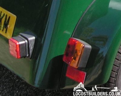

Macbeast
posted on 22/6/11 at 09:51 AM |
AFIK only the fog light has to be mounted vertically.
These passed
[Edited on 22/6/11 by Macbeast]

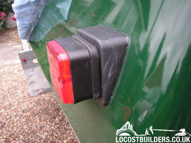

posted on 22/6/11 at 07:35 PM |
I had a query from Daniel Mason about the wedge I used to keep the fog light vertical.
If you look at the brake/indicator/tail light cluster you will see that it is mounted in a black plastic box. I had a spare one of these so I simply
cut the back box at about 25 deg to form a wedge. The fog light is fixed by long bolts that pass through the box and hold the whole thing to the rear
panel. This pic shows it better.
