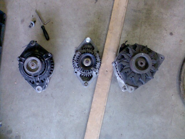

t.j.
| posted on 10/7/09 at 07:21 AM |
Found yesterday an alternator:
Can anyone tell me if the smallest one = suzuki swift will have enough to charge the battery?
Maybe someone knows which connections this one has in the back.
B+ is clear
D+ is (black white?) or (red white?)
- is (black white?) or (red white?)
Or should it have an extra minus?
t.j.
| posted on 27/7/09 at 07:41 PM |
I found it.
B+ is clear (30)
- is clear (31)
I have the round connector with:
1 horizontal and 2 vertical connectors
This is the plan looking at the back of the alternator:
horizontal = nothing
right = + coming from the alternatorlamp
left = + coming from the ignition (15)
Will take a while to let you know if it works... first make the electricity complete...
Have now a 4 v pulley which will work together with 4PK1123 belt
02GF: I like the timingbelt
[Edited on 27/7/09 by t.j.]
02GF74
| posted on 28/7/09 at 06:34 PM |
... quick update.
charged battery (small gel one)- didn't need much charge which surprised me as it has been left sitting for quite a few months and connected
wires to alternator.
Charge lamp (LED) does not come on unless the switched 12 V is connected to IGN on alternator (mine has 2 tags and the large B+ post).
next update will be when I get the engine running and hopefully to say that it charges plus the alt lamp goes off.
