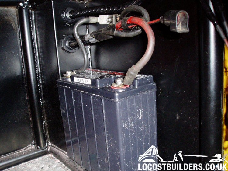

Mine is snug in the passenger footwell behind a velcro'd on panel. Keeps the engine bay nice and neat.
The other advantage I found was using the donor cabling totally unmodified. Still wrapped as it came off the Sierra.
This pic shows it in place but not secured....
