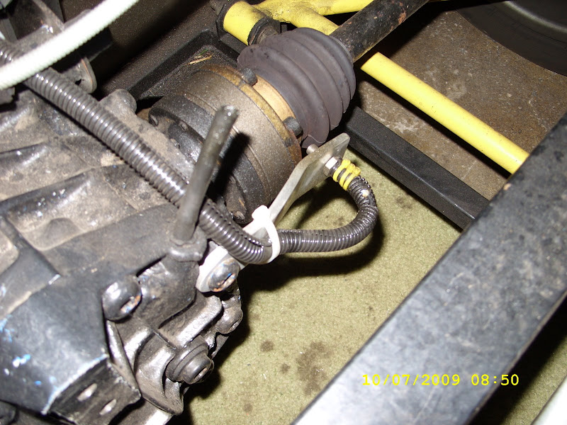

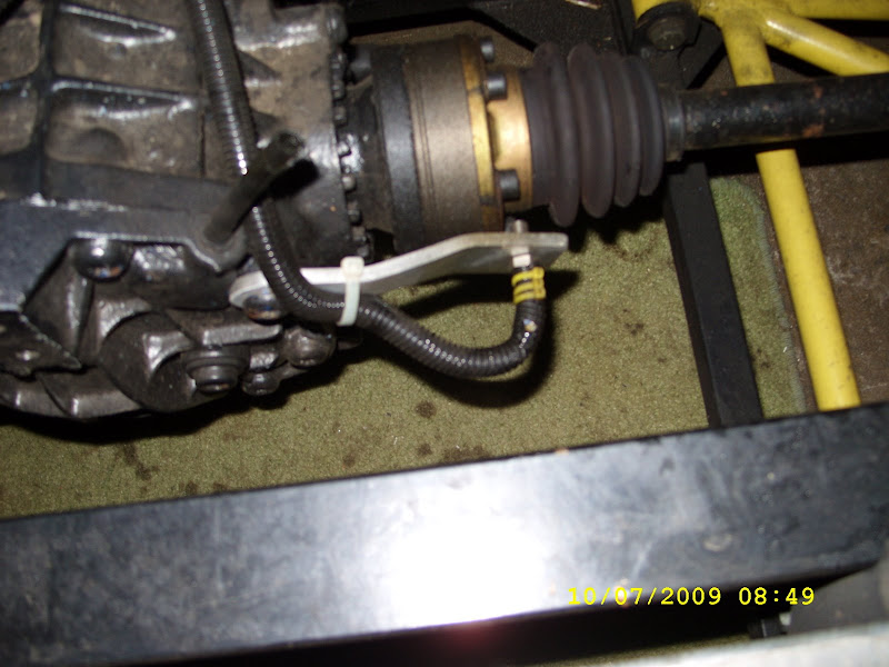

robinj66
| posted on 10/8/09 at 01:56 PM |
Nigel - I have the same diff as you. I drilled a shallow depression on the casing of the driveshaft and thenaraldited a single magnet in. The
bracket is mounted on the diff mounting bolt (so it moves with the diff)
