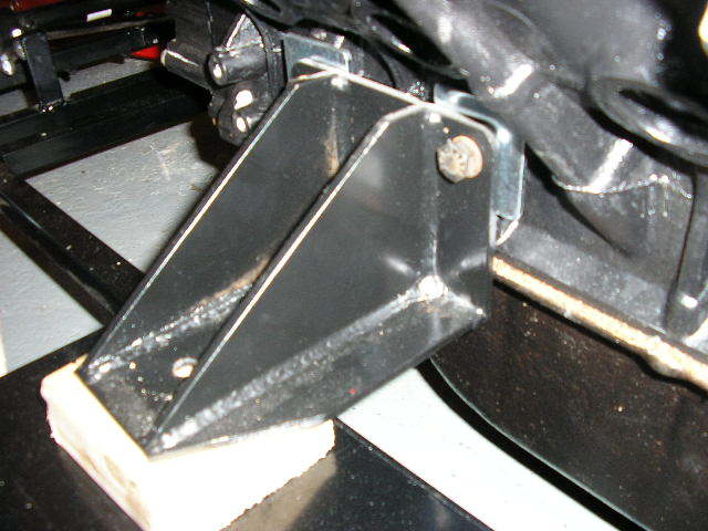

Paul (Notts)
posted on 27/9/09 at 07:05 PM |
If you have the same engine mounts as mine then this may help..
But you will have to sort new threads out in the block holes - engine out probably...![](/images//smilies/sad.gif)
I found the mounts touched the sump and would not lie true on the mounting holes so I placed a large square washer between the mounts and the engine
to avoid stressing the bolts.
Paul

Paul (Notts)
posted on 27/9/09 at 07:07 PM |
pic
[Edited on 27/9/09 by Paul (Notts)]
![](/galpreviews/a1023337-sep06 032.jpg) ![Rescued attachment sep06 032.jpg](/gallery/a1023337-sep06 032.jpg) Rescued attachment sep06 032.jpg
