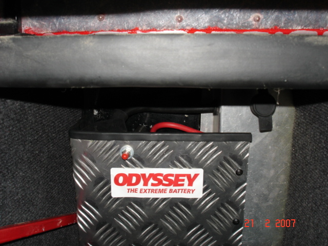

02GF74
| posted on 16/12/09 at 12:08 PM |
I have mine in passenger footwell.
There is an alloy box around ^^^^ similar to above but the full height of the battery plus a long long bolt inside a rubber hose for insulation going
over the top so battery cannot move in any dimension.
02GF74
| posted on 16/12/09 at 12:09 PM |
oooh, found a photo
splitrivet
