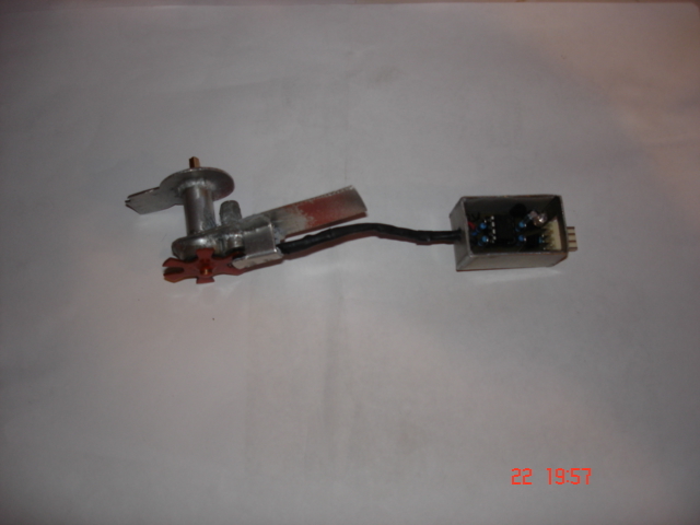

posted on 28/1/10 at 12:22 PM Reply With Quote
Here's mine (or the innards of it, anyway)...
speedo sender
speedo sender
This fits in place of the speedo cable on the side of a Type 9 box - not a lot of use to you, perhaps!

02GF74
posted on 28/1/10 at 02:15 PM Reply With Quote
If I had a lathe, then I too would have made something like David Jenkins' one.
I haven't so used bits of aluminium tube, lumiwelded together, brass spindle in bearing for the chopper wheel and hall effect sensor with magnet to look like this:
Not as neat as DJs I grant you but it works.
If you can, fit the sensor to the gearbox.
posted on 28/1/10 at 05:43 PM Reply With Quote
It was made by me - spent quite a while on the daily train working it out!
That one uses a hall-effect sensor, but if I did another I'd probably use an optical sensor instead.
