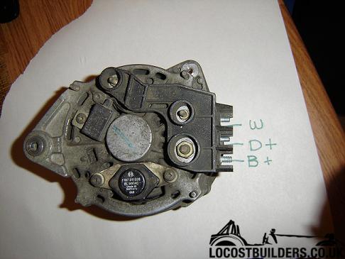

I have been helping a mate wire up his car .
Now I am at the alternator . From what I have found from searching is
B+
Sense
earth
That all makes sense , untill I have a look at the alternator and find
W , D+ and B+
Any help would be great
Vaughan
Below is link to photo of alternator
[Edited on 10/8/10 by vorn]http://www.locostbuilders.co.uk/upload/altornator.JPG

W+ : rev counter
B+ : Main output - normally connected directly to the positive terminal on starter solenoid. From there there should be a thick gauge cable to the
positive terminal on the battery
D+ : Charge warning lamp, lamps connected to switched ignition.

it could be used on a diesel engined car, which do not have ignition system.
if you wish to use it, be aware the the crank/alternator pulley sizes will affect the rpm signal.
