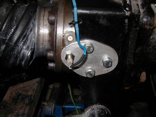

This is how I did the acewell one, great thing with the acewell is the magnet is mounted in a bolt so you just drill and tap the lobro casing.
[img]
[/img]
and this is how I did the 4 magnet telemetric (smiths) pain in the arse cos it took 4 days to stick the magnets on using the original 24hr araldite
not the rapid stuff.
[img]
[/img]
give russbost a shout he may be able to supply the acewell magnet and sensor
tony
