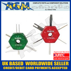

Its a long time since I looked at one but arnt they round pins ?
These are handy but I doubt you will find new pins. Soldered and heat shrink and they will look fine. The heat shrink crimps are nice but a little
bulkier for multi plugs.
