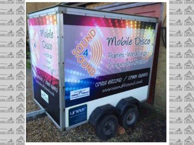

At the weekends I run a wedding disco service.
My disco trailer has 400 x 8" wheels / tyres, is it possible to buy a wider tyre to fit on the wheel as I sink in the mud?
Thanks in advance
Graeme

Put on some quad wheels and tyres if you want to stay at 8"

Will classic mini wheels fit ?
i have a small trailer that had the same size wheels as yours and swapped them for mini but had to cut a small slot to miss the grease nipple

was wanting to go wider without going higher, as the trailer height is spot on, just this time of year if I touch grass I sink, and my main market is
outdoor marque events.
might have to have a big change over in the spring.
quad tyres might work but think they might be taller will have to check.

You need to find your PCD, but most are 4 x 4"
then buy floatation wheels. if you can go to a trailer shop and check first as normally you need extended stub axles for floaties
these are the wheels and tyres you want, but they may rub on the trailer
20-5 x 8 -10 8 ply high speed wide floatation road tyre on 4"' pcd rim![](http://rover.ebay.com/roverimp/1/710-53481-19255-0/1?ff3=2&pub=5574934589&toolid=10001&campid=5336738914&customid=&item=123456&mpt=[CACHEBUSTER])
