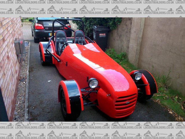

I've been talking to Chris today and I'm down to collect my kit on the 30th. Best make sure the cameras charged up as I lost the pics I took the last time I was down.
jim87
posted on 16/9/15 at 06:21 PM Reply With Quote
Originally posted by sdh2903
I think we need some pics of your car for inspiration Jim!
Hope these help!
ddfg778h
ddfg778h
ghjk7685
ghjk7685
Just need to trim an angle on the front wings and pass IVA, and I'm set.

posted on 16/9/15 at 06:28 PM Reply With Quote
I saw your car at MNR yesterday while Chris was showing me around. It looked fantastic up close.
sdh2903
posted on 16/9/15 at 06:43 PM Reply With Quote
Very nice.

Think I saw this couple of weeks ago at MNR, very well put together by the looks of it, you've done well. It almost convinced me to choose red
Stu
jim87
posted on 17/9/15 at 07:56 AM Reply With Quote
Wow - thanks for all the kind comments guys. It means a lot to me that people think it looks nicely done
Yeah, that's it at MNR at the moment. They're taking it to IVA for me.
